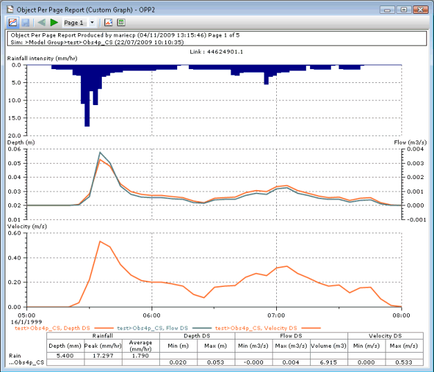

An example of a more complex report.
Example
Complex graph report

Multi page reports
Some more complex graph reports may contain more than one page. If the report contains more than one page, as seen in the example of a more complex report above, then you can scroll through the pages using the pgup and pgdn keys.
