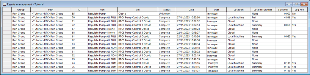

Results Management View
This view lets you manage results data stored in the current database.
Results Manager
To display the Results Management View, right-click the model group, live group, manifest or the database icon in the Explorer Window and select Open results manager from the popup menu.
The following versions of the view are available:
  • Group Management View: displays all simulation within a Group.
  • Model Group Results Management View: displays all simulations within a Model Group.
  • Live Group Results Management View: displays all simulations within a Live Group. Applicable for ICMLive functionality only.
  • Manifest Results Management View: displays all simulations within a Manifest. Applicable for ICMLive functionality only.
For more details on using the view, see Results Management.
