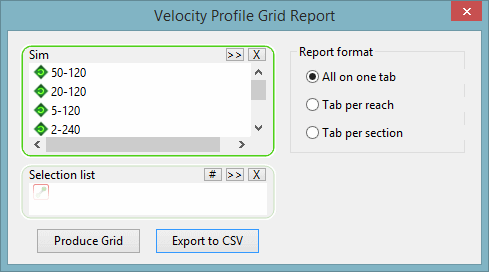

This dialog is used to produce a detailed breakdown of flow, bulk velocity and wetted area for a selection of river reaches. Values are provided at each timestep for each river reach section as a whole and for individual panels that make up the sections.
The report can be displayed in a grid view or exported to CSV format.
The dialog is displayed when Grid report
Velocity profile report is selected from the
Results menu.
Dialog description
| Item | Description |
| Sim |
A drop box for the simulations to be analysed. For cloud simulations, the results (full or summary) must be downloaded to your local results folder. A grid report will be produced for each simulation selected. |
| Selection list |
Optionally choose a
Selection List or click the
Results exported to the report will be restricted to river reaches in the selection list or current selection. If no selection is made all river reaches will be included in the report. |
| Report format |
Determines the report format:
| Produce Grid | Generates the report and displays it in the Velocity Profile Report View . |
| Export to CSV | Export the results to a CSV file. |
button to use the current selection in the active GeoPlan.
