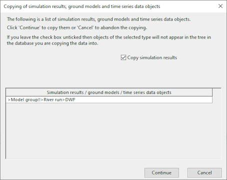

This dialog is displayed when copying between databases, where the items being copied include one or more simulations, ground models or time series data objects.
It lists all simulation results, ground models and time series data objects included in the items to be copied, and lets you choose whether or not to include them in the copy.
When copying into a transportable database, data is compressed to make the most efficient use of space. This process can be time consuming and it may be quicker to exclude results files, ground models and time series data objects at this stage and regenerate them when the data is needed.

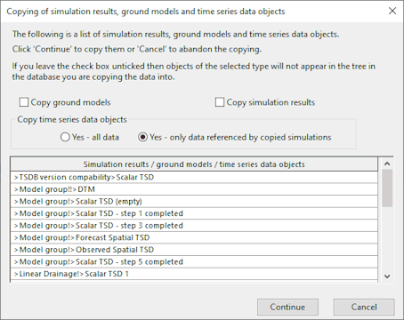

Example of dialog when an item containing one or more simulations, ground models and time series data objects is being copied.
Example of dialog when an item containing one simulation is being copied (no ground models or time series data objects)

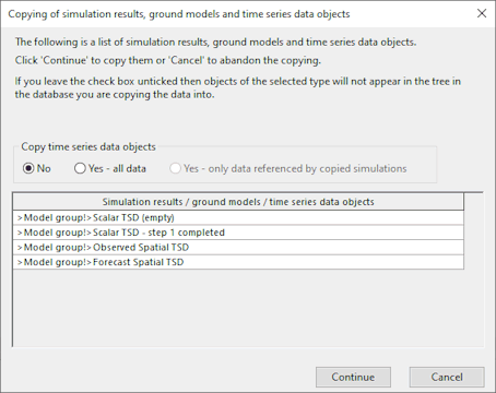

Example of dialog when only time series data objects are being copied (no simulations or ground models)

Copy ground models |
Available when at least one ground model is included in the item(s) being copied. Because ground models are potentially very large, you can exclude these files when making the copy by ensuring the box is unchecked.
Copy simulation results |
Available when at least one simulation is included in the item(s) being copied. Because results files are potentially very large, you can exclude these files when making the copy by ensuring the box is unchecked. Note: The box is disabled when copying simulation results from:
Copy time series data |
Available when at least one time series data object is included in the item(s) being copied. The following options are available:
Sim / Ground Model / TSD grid |
This grid lists the simulation results, ground model and time series data objects present in the items to be copied. These are the objects you need to make a decision about and decide whether they should be copied. |
Continue |
Copy the items using the selected settings. Displays the Copying of Simulation Results from Cloud Database dialog when the Copy simulation results box is checked and you are copying results from a cloud database to a transportable database, and one or more of the simulations have summary or no results downloaded. |
Cancel |
Abort the copy operation. |
