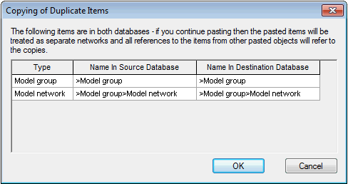

This dialog is displayed if you attempt to copy items with names that already exists in the destination database. The dialog lists the items that are being duplicated, giving their names and locations in both databases.
Note: Any duplicated items that are located in the
Recycle bin will be included in the list for
on-premise databases but not for
cloud databases.
If you click OK, items that already exist in the database will be duplicated there; the duplicate items have an exclamation mark (!) added to the names. Any items being copied at the same time that refer to these items will reference the duplicates rather than the originals.
If you click Cancel, no data will be copied (regardless of whether it is duplicate or not).
