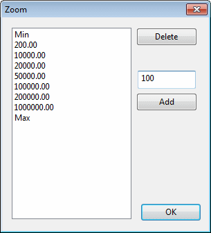

This dialog is used in InfoWorks ICM to add custom levels to existing zoom/scale levels to control visibility of objects in the GeoPlan (e.g. when using themes or auto-labels).
It is displayed when:
- The Edit Levels button is clicked in the General Page of the Options Dialog
- A user types in a custom level in a min / max box for visible range, provided the Show New Level dialog checkbox has been ticked in the General page of the Options dialog
Min / Max boxes for visible range are available from the following dialogs:
- Layer Theme Editor
- GeoPlan Properties - Elements Page
- Custom Label Settings Dialog - Formatting Page
The new value typed in the main or max box appears in the New Value box.
Create New Value - Add the new value to the existing value.
Use Next Lowest Value - Pick the existing value that is the closest to the new value, but lower.
Use Next Highest Value - Pick the existing value that is the closest to the new value, but higher.
Make this the default action - only available when Use next lowest value or Use next highest value have been selected. Check to indicate that the value selection criterion selected above is to be followed from now on. This means that the New Level dialog will not be displayed anymore and that the closest existing level (highest or lowest, depending on the selection) will be used instead.
