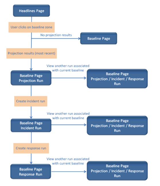

The primary user of the IWLive Pro Operator mode is the control room operator.
Projection runs are set up and scheduled by the IWLive Pro Administrator and are carried out automatically by the IWLive Pro Server.
The results of the projection runs are assessed for any warnings that a potential problem is likely to occur in the network in the next few hours.
Warnings are displayed in the Headlines page in the Operator by colour coded zones in a map view representing each network in the region. When a warning is displayed, the Operator can open a detailed map of the network in a Baseline Page in order to analyse the simulation results and identify the cause of the problem.
If zones have been defined, the Zones page of the Operator displays the zones defined for the baseline as well as warning information relating to each of these zones.
The Operator can create Incident and Response runs which are used to assess solutions to the potential problem identified by the projection run.
