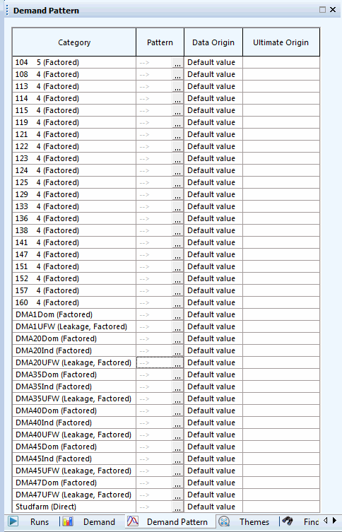

The Demand Pattern window allows the viewing and editing of demand patterns for the run currently selected in the Run Manager.
Note:
The Demand Pattern grid is read-only for projection runs and the model demand is still displayed to the user. Demand Patterns can be edited for incident and response runs.
The window is displayed on the left hand side of the Baseline Page.
To display the window:
  • Click the Demand Pattern tab on the left of the Baseline Page, or
  • Select Demand Pattern from the Window menu, or
  • Click the Demand Pattern button (Demand Pattern Window button) of the Window toolbar.
Demand patterns are listed by Category.
dialog field Description
Category
Name of the demand category
Pattern
Values defining the pattern of demand. Click the button to display the editor for that demand pattern.
Please refer to the InfoWorks WS Pro help for further details.
Data origin
Origin of the current data. The value depends on what has been set in the Fields window for the pattern.
Available options are described in detail in the Properties Window topic.
Ultimate origin
Origin of the parent data.
For permitted values, please refer to the Data origin field above.
If an incident run has been generated from a projection run,the Data origin field gets populated with Copied from parent and the Ultimate origin will have the same value as the projection run's Data origin field.
When the incident or response run is simulated, the demand pattern values are applied to the simulation. (The data in the Demand Pattern window is read-only whenever a projection run is open).
