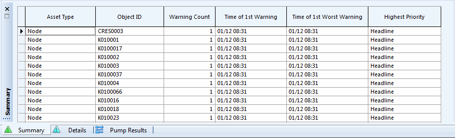

The Summary window (on the Baseline page) displays the total number of warnings for objects in the simulation currently displayed on the Baseline page.

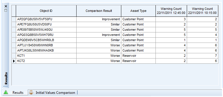

This window is known as the Results window on the Comparison page, which is displayed when users perform a run comparison. In this case, the total number of warnings is displayed for each run.

Summary window on the Baseline page
The Summary window is displayed on the Baseline page by doing one of the following:
  • Clicking the Summary tab at the bottom of the Baseline page.
  • Selecting Window | Results | Summary.
  • Clicking the Summary (Summary) tool on the Baseline Results toolbar.
To display the Results window on the Comparison page, do one of the following:
  • Click the Results tab at the bottom of the Comparison page.
  • Select Window | Results.

Item Description
Column headings
Asset type
The type of object. Examples: reservoir, pump station.
Asset ID / Object ID /User text
The object identifier, as set up in the Configure Display Rules dialog.
Configuration of asset display names is implemented in the Administrator mode.
Combinations of object identifier are allowed.
If the object does not have an Asset ID, the Object ID will be displayed instead.
Comparison result
Appears only in the Results window.
Result of the comparison between the two runs for the network objects. Permitted values are values from the comparison theme of the Comparison window.
Warning count The number of warnings that occurred for this object during the simulation.
Time of 1st warning
Appears only in the Summary window.
The time at which the first warning occurred in the simulation for this object.
Time of 1st worst warning
The time at which the first warning of highest priority occurred in the simulation for this object.
Highest priority
The priority of the highest priority warning (Background, Important or Headline).
