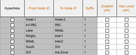

On the grid
The columns on the grid containing control information are grouped at the right hand side of the grid by default, and have column titles in italics and a different colour.
If the network has no control data associated with it, the columns will be visible, but all the cells will be disabled (coloured grey).
With associated control data, editable control data cells are drawn in white, or the colour of the flag for the data item. Simply edit one of these editable cells, and control information will be added for the network object.
When control information has been added for the network object, the Node ID field (nodes) or US Node ID, DS Node ID, and Suffix fields (links) are filled in automatically from the network object and displayed read-only for your information.

On the grid
The columns on the grid containing control information are grouped at the right-hand side of the grid by default, and have column titles in italics and a different colour.
Read-only cells are drawn in grey. All other cells can be edited.
