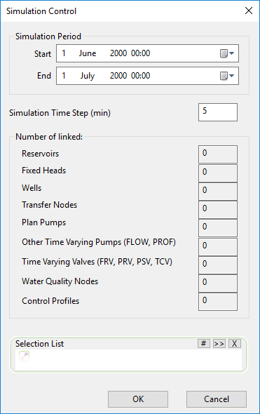

Some items in a control data set have specified dates and times or time varying data elements. The start and end times and simulation timestep for the control data set can be edited via the Simulation Control dialog.
To edit the control data simulation period and timestep:
- Select
Network | Control | Control time interval. The
Simulation Control dialog is displayed with the default Simulation Period.
Show image
- Edit the Simulation Period Start and End times and Simulation Time Step as required.
- Click
OK to apply any changes.

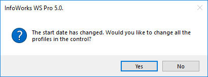

- If the Simulation Period is modified such that the interval is outside of the default Simulation Period Start and End Times, the following dialog will be displayed:
Show image
- Click Yes and only the control data that fall within the default Simulation Period will be changed along with it. Any control data that fall outside the default Simulation Period will not be changed, and will only be used if the modified Simulation Period coincides with the control data.
- Click No and only time values will be changed. The control data of network objects will not be changed
