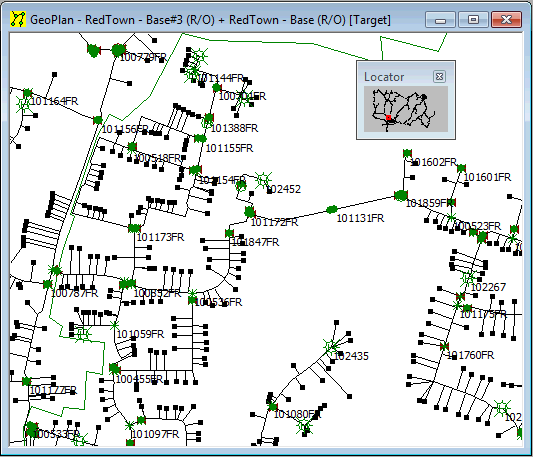

Viewing customer points
Customer points can be displayed on the GeoPlan Window. See Viewing Customer Points on the GeoPlan.
Customer points can be viewed and edited on the Customer Points Grid and the Customer Point Property Sheet.
