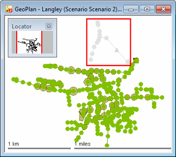

Network objects present in the base network but not in the current scenario are displayed as a faded grey colour in the scenario GeoPlan window. Display of these 'object ghosts' can be turned on/off from the Visual Page of the GeoPlan Properties dialog.
