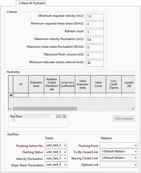

This page is divided into three sections:
  • Criteria: specifies the criteria to be used to evaluate the effectiveness of flushing actions
  • Hydrants: defines the hydrant characteristics of flushing points
  • GeoPlan: sets the controls for display of flushing schedule actions in the GeoPlan window
The page is opened by clicking the Criteria & Hydrants tab on the Flushing Scheduler.
Criteria section
This section is used to:
  • specify the criteria to be used to evaluate the effectiveness of flushing actions
  • apply a limit to the water used in flushing
  • calculate and check action timings in the flushing schedule
Criteria Description Default Value
Minimum required velocity
Minimum required velocity in pipes being flushed.
1.5 m/s
Minimum required shear stress
Minimum required shear stress in pipes being flushed.
A value of 0 means no check will take place.
0
Refresh count
The number of times the water in a flushed pipe should be refreshed.
3
Maximum velocity fluctuation
Maximum fluctuation in velocity in pipes that have not yet been flushed and are not being flushed in the current flushing action.
0.4 m/s
Maximum shear stress fluctuation Maximum fluctuation in shear stress in pipes that have not yet been flushed and are not being flushed in the current flushing action. 0
Maximum flush volume
Maximum volume of water to be used per flushing action.
0
Minimum between action interval
Minimum time interval between the end of one flushing action and the start of the next.
30 mins
Hydrants section
This section is used to define flushing point characteristics.
Each row in the hydrants grid defines a hydrant type which can then be assigned to a flushing point in the Selected Action section of the Schedule page.
Item Description
Grid columns
ID
Hydrant Type identifier.
Diameter
The internal diameter of the hydrant fitting.
Relative Outlet Elevation
Elevation of the hydrant outlet to be used in flow calculation RELATIVE to the node elevation.
Local Loss Coefficient
Branch minor loss coefficient. The headloss coefficient due to change of flow direction and diameter change.
Valve Diameter
Diameter of the hydrant valve when fully open.
Valve Curve
The name of the hydrant valve curve.
If there is a network open, a valve curve from the current network can be selected from a dropdown list.
See the Valve topic for more details on types of valves.
Loss coeff (open)
Local headloss coefficient when the hydrant valve is open.
Length
The length of pipe associated with the hydrant.
Default value = 0.
Friction Type
The formula used for roughness calculations. Can be Darcy Weisbach, Hazen Williams, or Colebrook White. See Pipe calculation information.
CW - k
HW - c
DW - f
The roughness of the pipe associated with the hydrant
Fire Flow
For defining a hydrant type based on fire flow data.
A Fire Flow Data object dragged here will be used to populate the hydrant characteristics.
Note: The Hydrants grid contains additional optional attributes (for length, friction type, and roughness) that are not defined for fire flow data objects.
Pick Hydrant
For defining a hydrant type based on a hydrant object on the GeoPlan.
Clicking the button then selecting a hydrant on the GeoPlan will populate the hydrant characteristics from the hydrant node data.
Note: The Hydrants grid contains additional optional attributes (for length, friction type, and roughness) that are not defined for hydrant nodes.
GeoPlan section
Settings in this section affect the display of flushing schedule actions in the GeoPlan window. The display controls apply when a single Action is selected on the Schedule page.
GeoPlan themes and labelling can be used to display flushing status and velocity fluctuation graphically.
Field Description Default Value
Flushing Action No. Field
The selected User Text field will be used to display the action number for pipe objects.
Flushing Status Field
The selected User Text field will be used to display the flushing status value for pipe objects.
Flushing status value may be set to:
  • Not Flushed
  • Being Flushed
  • Flushed
user_text_4
Velocity Fluctuation Field
The selected User Text field will be used to display the velocity fluctuation value for pipe objects.
The field will be blank if the velocity fluctuation criterion is not exceeded before the pipe is flushed. If there is a velocity fluctuation problem in the pipe, the amount of the velocity fluctuation, the action number at which it first occurred, and the action number at which the pipe was flushed will be displayed.
user_text_5
Flushing Point marker
The symbol defined for the selected spatial data type will be used to mark nodes defined as flushing points in the currently selected action.
To Be Closed Link marker
The symbol defined for the selected spatial data type will be used to mark links defined as to be closed in the currently selected action.
<Default Marker>
Staying Closed Link marker
The symbol defined for the selected spatial data type will be used to mark links closed in a previous action that will remain closed during the currently selected action.
Opened Link Marker
The symbol defined for the selected spatial data type will be used to mark links defined as open in the currently selected action.
