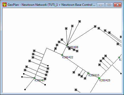

Spatial Data points displayed on the GeoPlan

Viewing spatial data points
You can display spatial data points on the GeoPlan window. See Viewing spatial data on the GeoPlan.
