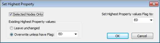

Set Highest Property dialog
This dialog is used when setting the highest property at each node.
The dialog is displayed by selecting Model Set highest property. If the menu option is unavailable, it is because the current network is using the lock method of version control and is not checked out.
Item Description
Selected Nodes Only If checked, only the nodes currently selected on the network will have their highest property values set.
Existing Highest Property values
Leave unchanged Does not change existing highest property values.
Overwrite unless have flag
Overwrites existing highest property values unless they have the flag that you can enter into or choose from the adjacent dropdown list.
If you choose this option but do not specify a flag, all existing high property values will be overwritten.
Set Highest Property values Flag to If you enter or choose a flag in this box, all the changed highest property values will have this flag set against them.
