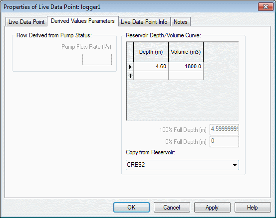

  3. Enter a Depth / Volume curve for the reservoir being monitored into the grid on the Derived Values Parameters Page of the Live Data Point Property Sheet. (If there is a network open, select a network reservoir from the Copy from Reservoir: dropdown list to copy the Depth / Volume curve from the network to the grid.)
    Show image
The depth values at which the reservoir is considered empty (0% Full Depth) and full (100% Full Depth) may also be defined in the Derived Values Parameters page:
  • If a reservoir Depth/Volume curve is copied from a network reservoir, the 100% Full Depth value will automatically be set to the last Depth value in the curve.
  • If depth values are not defined, a 0% Full Depth of 0.0 will be assumed. The 100% Full Depth value will be assumed to be the last Depth value in the Depth / Volume curve.
