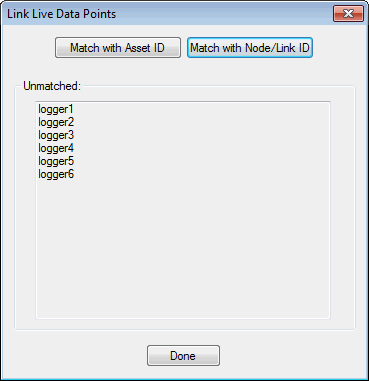

Linking Live Data to the Model Automatically
Live Data can be automatically linked to the model if the Live Data ID corresponds to the Asset ID or the Node/Link ID of the location at which the measurement was taken.
To automatically link live data to the model, open a Network, associated Control Data Set to be updated and Live Data Configuration containing data to be linked.
  1. Select Control > Link Live Data Points from the Network menu. The Link Live Data Points dialog will be displayed.
  2. Select an option from the Link Live Data Points dialog:
    • Match with Asset ID
    • Match with Node/Link ID
InfoWorks will attempt to match Live Data Points that have not already been linked to the model with the Asset ID or Node/Link ID of network objects depending on the option chosen above.
Control parameters will be added to network objects that are matched to live data and the Live Data Point ID field of the objects will be populated with that from the matched Live Data Point.
A list of unmatched Live Data Points will be displayed in the Link Live Data Points dialog.
  1. Click Done to exit the dialog.
