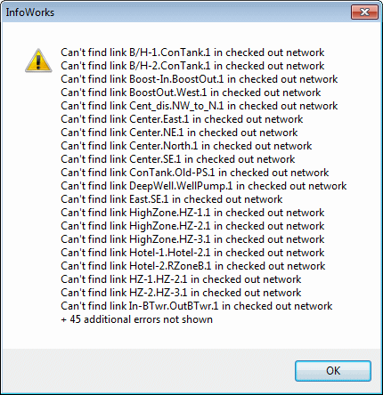

    If you choose a calibration run that uses a different network, when you continue you will see an error dialog. Show image. Any links that have the same name will be updated.
