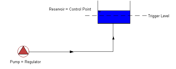

The following example shows a scenario for starting a pump when the level in a reservoir drops to a defined depth.
Under this scenario, the pump will be switched on when the pressure at RHighL (depth in reservoir RHighL) drops below the trigger level of 2m. When the level in the reservoir rises to 2m the pump will be switched off by default.

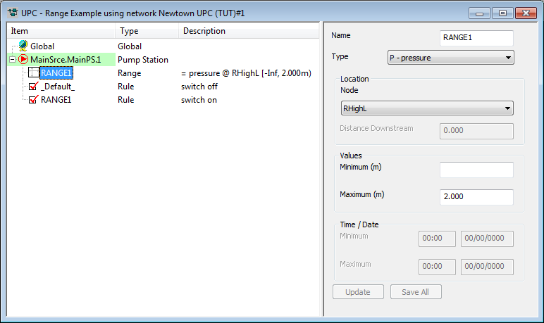

RANGE 1
Range type: Pressure
Location node: RHighLMinimum: Maximum: 2m
TRUE if pressure at node RHighL is less than 2m

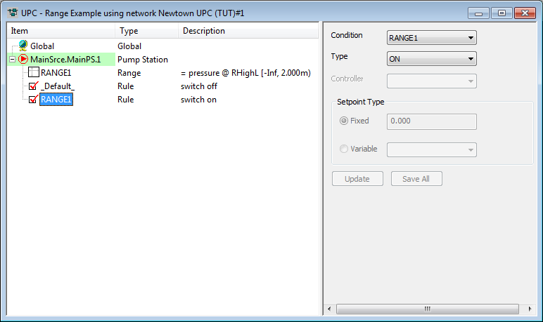

RULE 2
Condition: RANGE 1Rule type: ON
Switch pump ON if RANGE 1 is TRUE
  1. Range 1: Defines Reservoir RHighL as the control point with a maximum value of 2m.
  2. Rule 1: Unless subsequent rules are TRUE, the pump will be set to the default status of OFF.
  3. Rule 2: Switches the pump ON if the level in the reservoir is below 2m.
