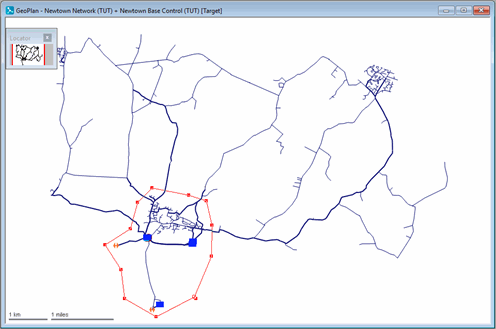

- Make a selection in the network. You can, for example, use the
(Polygon select) tool to select some nodes and links. Double-click to close the polygon. Alternatively, choose a different selection tool (see
Finding and Selecting Objects topic for more selection tools).

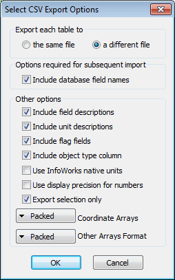

Export | To CSV. The Select CSV Export Options dialog is displayed.
- If necessary, select a different file instead of the same file. The CSV files imported earlier contained all the data in one file. This time the export process will create a series of export files, one for each type of data.
- Check the Export selection only option. Leave the other options as they are and click OK. If you want to export the entire network do not check the Export selection only check box.

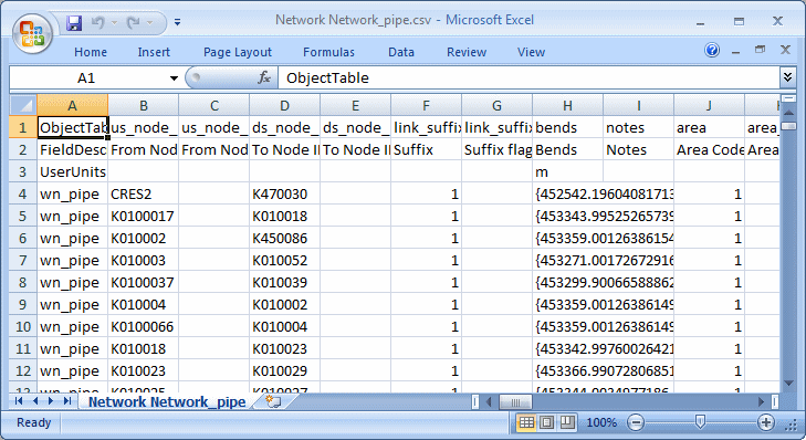

- Open 'Newtown Network_pipe.csv' in Excel. The file contains the complete set of fields (including data flags if the Include flags fields option was chosen) for all the pipes that were part of the selection in the network. Close Excel.
