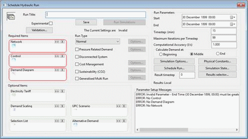

- Right-click the Run Group and select
New | Run. The Schedule Hydraulic Run dialog is displayed.
- In the Run Title box, enter the title as 'Newtown Run 1'.
- Drag a network into the Network box. Let us select the following network as an example: Newtown Network.
- Drag the Newtown Base Control object into the Control box.
- Drag the Profiles demand diagram into the
Demand Diagram box.
- Change the
Start date and time to 1 October 1998 00:00 and the
End date and time to 2 October 1998 00:00. The
Timestep
(the frequency at which calculations are performed) should be 5 minutes. Change the
Computational Accuracy to 0.5 l/s .
- Run the simulation:
- Click Run Simulations. The Output window is opened, showing the progress of the run.

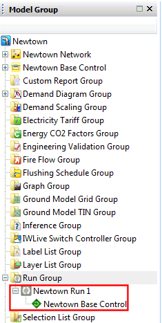

- Click the
button for the Runs group and you will see that it now contains the Newtown Run 1 run, which in turn contains the Newtown Base Control simulation.
The simulation icon is green, indicating that the simulation was completed successfully. This does not mean, however, that the model run has not suffered from any instabilities.

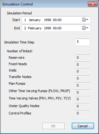

- You can change the dates and times over which the simulation is run:
- Open the Newtown Network network.
- Drag the Newtown Base Control icon onto the GeoPlan.
- From the
Network menu, select the
Control time interval option. The Simulation Control dialog is displayed. This dialog allows you to change the start and end dates and times and the simulation timestep. All dates and times in the control data will be moved relative to the new start date and time.
For these changes to take effect, the control data must be checked out. The data in the network is not affected, so the network does not need to be checked out.
- Click Cancel to cancel the changes.
