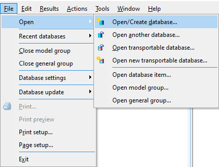

To open the example database:
- Start InfoWorks WS Pro.
- Select the example database:
- From the
File menu, choose
Open, then
Open/Create database.
- The Open/Create dialog is displayed.
- Click Standalone and the Open Standalone Database dialog is displayed.
- Click the New button. A Windows Save As dialog is displayed.
- Select a folder for the database to be held, then click Save.
- Using
File | Open | Open transportable database navigate to the file WSProTutorial.wspt in the
Example Data directory, then click
Open.
