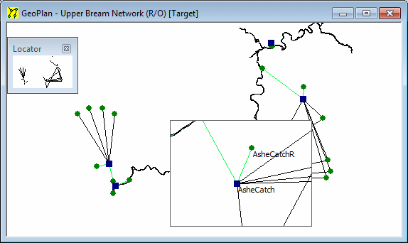

GeoPlan Magnifier
If your network is very busy and if you would like to magnify the display without repeatedly clicking the Zoom in button, simultaneously click the Shift and Ctrl keys of the keyboard. Move the mouse across the GeoPlan to hover over other areas of the network and magnify them. When done, press the Esc key of your keyboard to exit the Magnify mode.

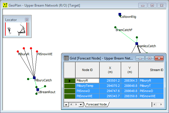

Display a selection of objects of the same type in a grid
If the GeoPlan has some objects selected (objects highlighted in red), it is possible to open the corresponding grid with only the selected objects in it (these objects have to be of the same type). For this, ensure that the objects are selected in the GeoPlan and keep the Ctrl key of the keyboard down while opening the relevant grid.
