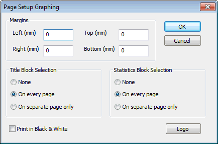

Page Setup Graphing dialog
This dialog is used to set up the page options for a graph.
Notes:
  • Printer, paper size, source and default page orientation options can be configured on the Print dialog (File | Print).
  • There is no print preview feature on this dialog: you can see a print preview by selecting File | Print preview.
The dialog is displayed when you choose File | Page setup when a Graph view is the current active window.
Item Description
Margins Default is 0, which means no margins. Set any margin you require by entering the size in millimetres.
Title Block Selection
Statistics Block Selection
Use the Title Block and Statistics Block options (displayed when viewing a saved graph) to control the display of the graph title and statistics table.
None Block will not be displayed in printout.
On every page Title block will be displayed at the top of each graph page. Statistics block will be displayed at the bottom of each graph page.
On separate page only Block will be displayed on a separate page from the graph.
Print in Black & White Check this box to print in black and white instead of colour.
Logo button
Opens the Print Setup Logo dialog, for printing a user-defined title and logo at the bottom of the page.
