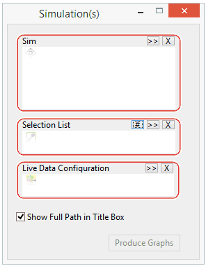

This dialog allows you to select one or more simulations, network objects within the simulations and live data associated with the simulations, that will be covered by the report.
The dialog is displayed by selecting Results | Graph Reports | Simulation(s) report.
| Item | Description |
| Sim[ulation] | You can add items of the correct type by dragging and dropping from the Explorer window or
Model Group window, or using the
button to add items and the
button to delete all items from the box.
| Selection List | |
| Live Data Configuration | |
| Show Full Path in Title Box | Displays the full path of the simulation object in the graph title box. Unchecking the box displays the simulation name only. |
| Produce Graphs | Generates the report. |
