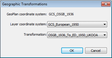

Geographic coordinate transformations
When using ArcGIS as map control, geographic transformations can be specified to allow data sets which have different geographic coordinate systems to be mapped together.
Click the geographic coordinate transformations Edit button on the Projected Coordinate System dialog to display the Geographic Transformations dialog.
Transformations available are those which are related to the current GeoPlan coordinate system. One transformation may be selected for each available coordinate system.
Transformations are saved as part of the coordinate system. Changing the GeoPlan coordinate system will clear all previously set transformations.
