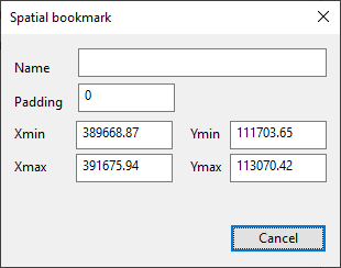

This dialog is used to save view extents for a particular view with a name that will then be selectable from a list in the Spatial Bookmarks window.
The dialog is displayed when one of the Add options from the GeoPlan
Spatial bookmarks sub-menu is selected, or when a bookmark in the Spatial Bookmarks window is double-clicked.
| Item | Description |
| Name | For entering the name of the spatial bookmark. The name will appear in the list of bookmarks in the Spatial Bookmarks window. |
| Padding |
Adds extra space around the view extents defined by the coordinates displayed in the dialog. The coordinates will be updated as the padding value is entered. The padding value uses the same units as the X, Y coordinates. Not available when displaying the dialog from the Spatial Bookmarks window. |
| XminXmaxYminYmax |
Coordinates defining the extents of the bookmarked view. One of the following, depending on how the dialog was opened:
| OK |
Creates the spacial bookmark and closes the dialog. Not available until a name has been entered into the Name box. |
| Cancel | Closes the dialog without creating a spacial bookmark. |
