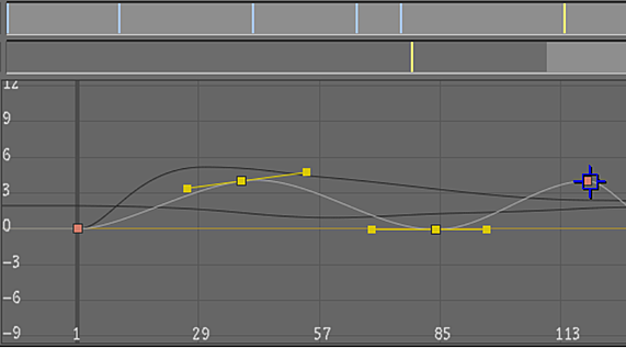

To select multiple keyframes:
In the Animation Curves window, click a keyframe to select it and then hold down Ctrl and click additional keyframes to add them to the selection.
Note:To deselect a selected keyframe, hold down Ctrl and click the keyframe. This is useful when you make a marquee selection but you would like not to include one or more keyframes in the selection.
If you release the Ctrl key and then click a keyframe, this keyframe is selected and the previous selection is cleared.

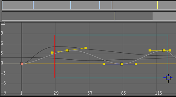

To marquee select multiple keyframes:
In the Animation Curves window, drag to draw a marquee selection rectangle around the keyframes you want to select.
Keyframes inside the marquee selection are selected.
To zoom in on the selected area, hold down the Alt key when drawing the marquee selection.
