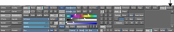

To copy channel parameters from the current shot to selected shots:
Click Selector.
