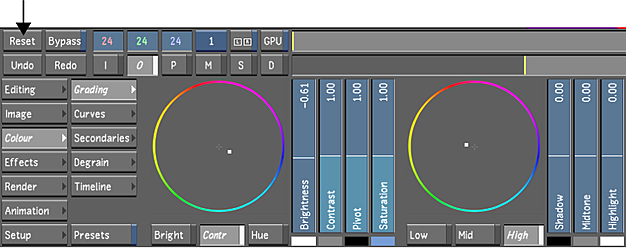

  2. Access the menu you want to reset.
  3. Click Reset, and then confirm.
    The menu is reset.
