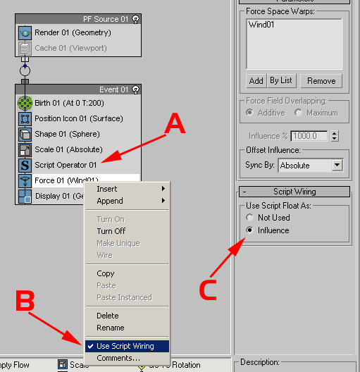

To get the Script Wiring, you have to do the following:
  • A: Add a Script Operator before the Force Operator to generate the Particle Float channel values needed to control the Force Influence.
  • B: Right-click the Force Operator and check the "Use Script Wiring" option.
  • C: This enables a new additional rollout in the Force Operator that lets you enable the Influence Control through the Float channel.
