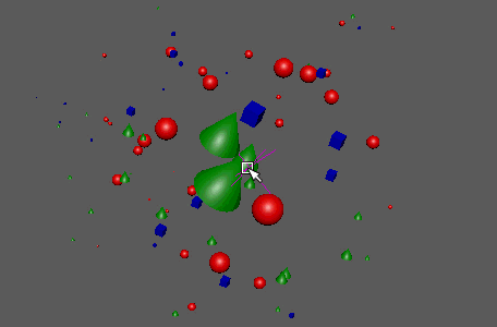

Influence
Influences the scale and rotation of object instances according to the scale and rotation of connected influence locators. A starting locator is automatically added to the scene by default.

Influence Power
Controls how quickly the influence locator's effect falls off away from the center of its radius. Higher values make falloff more pronounced.
Use Radius
Allows you to manually adjust the Influence Radius (area of effect) around locators. When turned off, influence nodes will affect the entire network and automatically fade between any other influence locators.
Influence Radius
The maximum range of a locator's influence when Use Radius is enabled.
