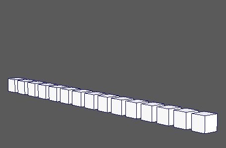

Delay
Allows you to inherit the animation of an object, then offset it in time.
MASH Delay
Delay Mode
Sets the delay method. Options include:
  • Normal: Delays the effects of the connected nodes in the network per object instance.
  • Follow the leader: Sets the object instances to follow a leader object on a delay.
Time Step
Controls the total time of the delay (in frames).
Time Variance
Controls the amount of randomization added to the time step on an object by object basis.
Time Offset
A backward offset for the time step.
Delay Position, Delay Rotation, Delay Scale
Specifies the channels to delay.
Leader
Allows you to set an object for the MASH network to follow when Delay Mode is set to Follow the leader.
