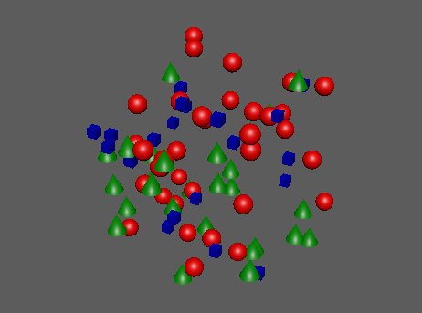

Allows you to assign different objects to MASH points.
Note: Should be added to the Instancer's ID channel.
ID Node
ID Type
The type of ID distribution. Options include:
  • Linear: Increments the ID of each object by 1. Loops if there are not enough objects.
  • Random: Each object gets a random ID. You can adjust the probability of certain IDs of certain IDs showing up over other IDs using the Probability Ramp.
  • Cycle: IDs are incremented per frame.
  • Fixed: Each ID is the same.
