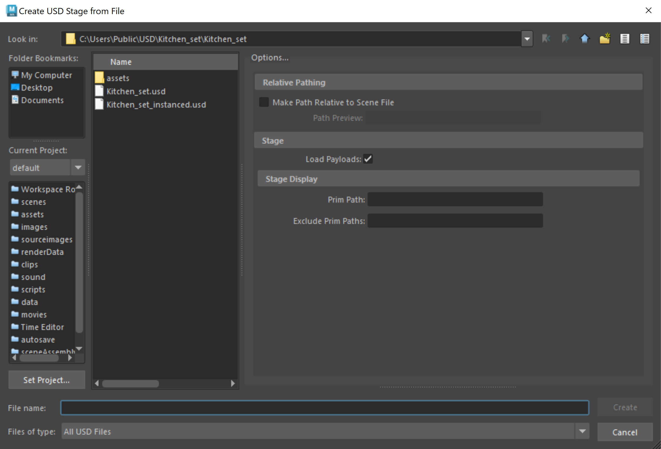

  2. In the Create USD Stage from File window that appears, you can select a USD file and set the following USD File Options:
    Important: If you have Windows > Settings/ Preferences > Preferences > Files/ Projects > File Dialog set to OS Native, you will see your operating system's file browser instead of this dialog. In this case, to access the USD File Options settings, click Create > Universal Scene Description (USD) > Stage from File > .
    Relative Pathing
    • Make Path Relative to Scene File: Save an anonymous root layer relative to your Maya scene file and sublayers relative to parent layers. To enact this, ensure you save your Maya scene file to disk when you toggle this setting on to enact your relative pathing selections. To learn more about saving USD files relatively, see Make Path Relative.
      Stage
    • Load Payloads: When on, loads all prims marked as payloads. When off, all prims marked as payloads and their children are not loaded.
      Stage Display
    • Prim Path: Loads the specified prim path. If a matching prim path is not found, all prims in the file are loaded.
    • Exclude Prim Paths: Excludes the specified prim paths from the loaded USD data. Multiple prim paths must be separated by a comma.
  3. Once you are done making changes, click Create.
