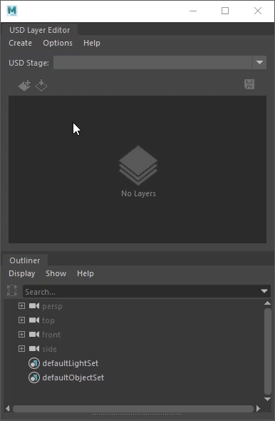

Creating a stage with a new layer lets you start with an empty USD stage and an anonynous layer. Using this empty layer and stage, you can structure your layer hierarchy using the USD Layer Editor. When new layers are created in Maya, they are empty and anonymous. You can add prims and references to any layer using the Outliner. This workflow enables the creation of USD assets within Maya.
To create a new empty USD stage with sublayers
  1. Do one of the following:
    • In the USD Layer Editor, Create > Stage with New Layer (recommended)
      Note: To open the USD Layer Editor, Select Windows > USD Layer Editor.
    • Create > Universal Scene Description > Stage with New Layer
  2. The following occurs:
    • In the USD Layer Editor, an anonymous root layer and a session layer are created. The new anonymous root layer is set as the target layer.
      Note: The session layer is set by default to auto-hide in the USD Layer Editor. Please see Auto-Hide Session Layer to toggle the visibility of the session layer.
    • In the Outliner, a proxyShape transform node named stage1 and a stageShape stage node named stageShape1 are created.
      Tip: In the Outliner, right-click stage1 or stageShape1 and select USD Layer Editor to open it.
