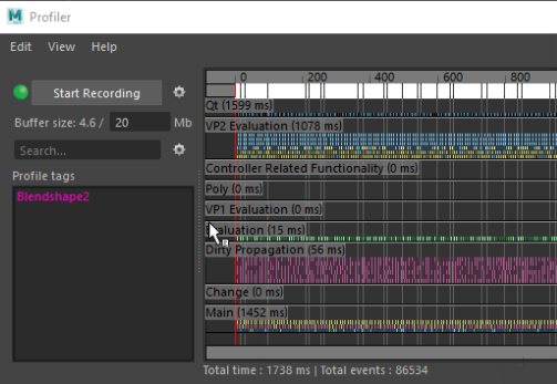

addProfilerTag("Blendshape2", 255, 0, 200); getMetadata -streamName "ProfileTagStream" -memberName "NodeProfileTag" -channelName "ProfileTag" -index "0"; - Open the Profiler, click Start Recording, and then play your animation
- When you've captured a small amount of animation, click Stop Recording.
The Tag appears in the
Profiler If you select the tag, all the related data in the output is selected.
