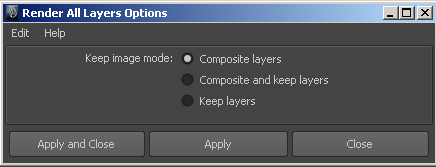

To preview render layers in the Render View
- To view all your layers composited with the specified blend mode settings, turn on Render All Layers in the Options menu of the Render Layer editor or the Render menu of the Render View.
- By default, a composited result of all layers is shown in the Render View.
- To view all your layers rendered as individual images, change the
Render All Layers option () from
Composite Layers to
Composite and Keep Layers, or just
Keep Layers.
Note: Using Keep Layers significantly increases memory usage in Maya. Consecutive use populates the Render View with more and more images. You must clear out images manually as needed. - To preview the composite of only some layers, turn on
Render All Layers, and turn off the
Rendering flag on the layers you want to exclude (click on the
icon next to the layer name).
- To preview a particular layer, select it and make sure the Render All Layers option is turned off.

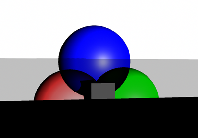

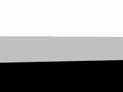

The following examples show a very simple scene: three spheres colored red, green, and blue, with a small plane in front casting a shadow.
The spheres are in the foreground and are rendered with various blend modes against a white, gray and black background.

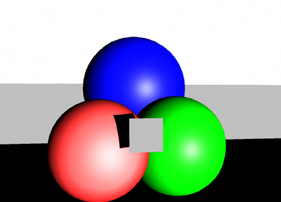

Normal |
The foreground texture is applied like a decal to the background. The shape of the decal is determined by the foreground alpha. |

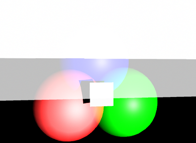

Lighten |
Uses whichever pixel in the rendered layer is lighter as the resulting color. |

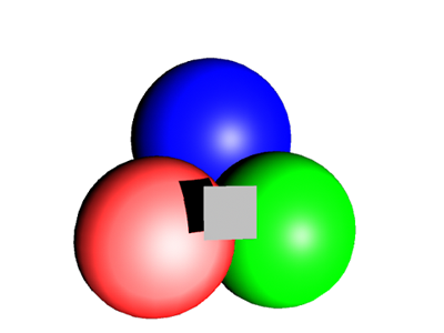

Darken |
Uses whichever pixel in the rendered layer is darker as the resulting color. |

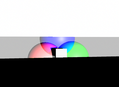

Multiply |
Multiplies the composited render's color by the rendered layer color. The resulting color is always a darker color. Multiplying any color with black (value of 0) produces black. Multiplying any color with white (value of 1) leaves the color unchanged. |

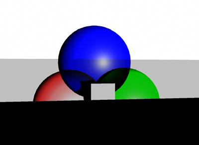

Screen |
Multiplies the inverse of the rendered layer and the composited layers colors. The resulting color is always a lighter color. Screening with black leaves the color unchanged. Screening with white produces white. |

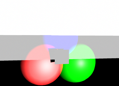

Overlay |
Multiplies the colors, depending on the composited color. Patterns or colors overlay the existing pixels while preserving the highlights and shadows of the base color. The base color is mixed with the rendered layer color to represent the lightness or darkness of the original color. |
