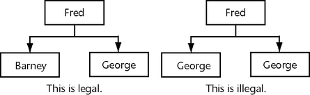

Unique Names
The use of the DAG path allows for object names to be reused. Object names can be reused as long as the same name does not appear on more than one DAG node with a common parent.
