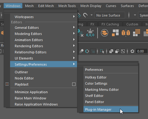

  1. Open the Plug-in Manager. Click on Windows > Settings/Preferences > Plug-in Manager to open the Plug-in Manager.

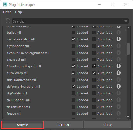

  2. Click on Browse in the Plug-in Manager.

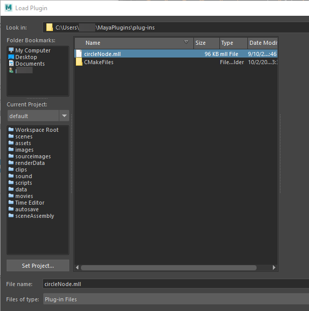

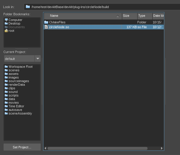

  3. Navigate to the location of the plug-in and double-click on it.
    On Windows, samples are built to the build\Debug\ directory under the sample name. Windows plug-ins have the mll suffix. For example, to load the Windows circleNode plug-in, navigate to circleNode\build\Debug\ and select circleNode.mll.
    alt text
    On Linux, samples are built to the build directory under the sample name. Linux plug-ins have the so suffix. For example, to load the Linux circleNode plug-in, navigate circleNode/build/ and select circleNode.so.

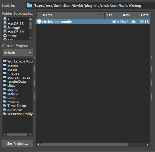

    On macOS, samples are built to build/Debug/ if they were built with XCode. Otherwise, the sample plug-in will be located in the top level of the build directory. macOS plug-ins have the bundle suffix. For example, to load the macOS circleNode plug-in built with Xcode, navigate to circleNode/build/Debug/ and select circleNode.bundle.

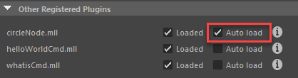

  4. Plug-ins added manually will not be loaded into Maya automatically. They need to be reloaded into Maya every time Maya restarts.
    If you want your plug-in to be loaded automatically, select its Auto load option.

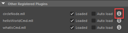

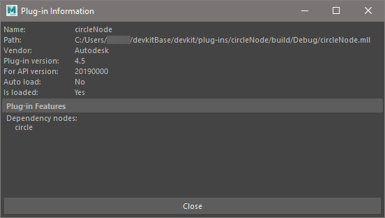

  1. To find out how to use the plug-in, click on the plug-in's i icon in Plug-in Manager.
    alt text
    This will bring up the plug-in's information, including whether it is a dependency graph node or a command, and for which version of the API it was built.
    Important:
    Plug-ins need to be rebuilt for each new version of Maya and its API.
    alt text
