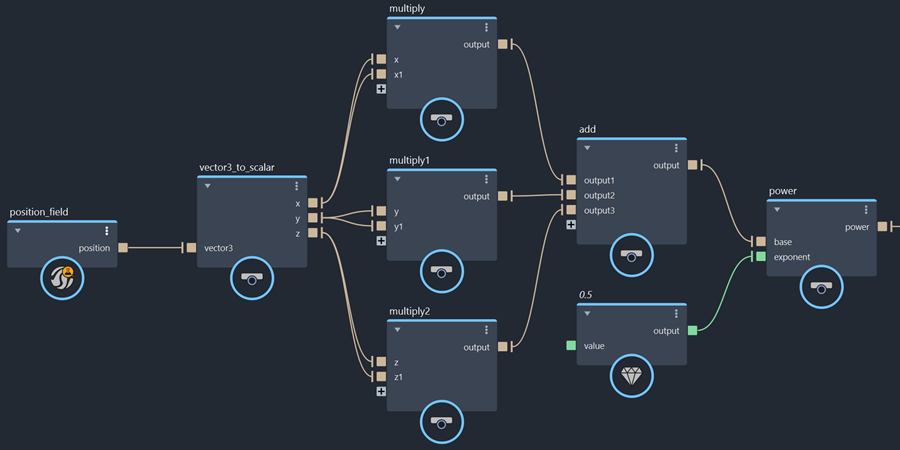

Position field
Although sampling a field always involves evaluating it at positions, it is sometimes also necessary to use the position explicitly for defining a field's formula. For this, you can use the position_field
node to get the position values, followed by vector3_to_scalar
to get the constituent X, Y, and Z values if necessary.
For example, the formula √(x² + y² + z²) gives the distance from any position to the origin.
