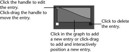

The Attraction Scale ramp attenuates the Start Curve Attract attribute value along the length of the follicle’s hair clump. Attraction Scale on the follicle node is a per hair clump override of the hairSystem node’s Attraction Scale.
You can use the ramp graph to define a varied stiffness for your hair clump from root to tip. The leftside of the ramp graph represents the root of your hair clump and the rightside represent the tip. For example, if you want the root of your hair clump to be less stiff than its tip, then the value on the rightside of the ramp graph should be smaller than the value on the leftside.
The Attraction Scale ramp values are multipliers of the Start Curve Attract attribute value on the follicle. So an Attraction Scale of 1.0 does not affect the Start Curve Attract, and a Start Curve Attract of 0.0 is not effected by Attraction Scale.
Selected Position
This is the position along the current hair clumps for the point selected on the Attraction Scale graph. This is also represented by the position of the point on the X-axis.
Selected Value
This is the scale value associated with the Selected Position on the Attraction Scale graph for the current hair clump. This is also represented by the position of the point on the Y-axis.

Stiffness Scale
Stiffness Scale affects the stiffness from root to tip of the hair. The left of the graph is the root and the right is the tip. Typically the root of a hair is thicker and therefore stiffer than the tip. This attribute multiplies the Stiffness parameter value, so a value of 1.0 leaves the Stiffness unchanged. However, if the Stiffness attribute is zero, then this parameter has no effect.
This option overrides the Stiffness Scale attribute of the related hairSystemShape for the specified follicle. The Stiffness Scale attributes are not available when the follicle’s Override Dynamics attribute is disabled.
Selected Position
This is the position along the hair follicle of the currently selected point on the Stiffness Scale graph. This is also represented by the position of the point on the X-axis.
Selected Value
This is the stiffness value associated with the Selected Position on the Stiffness Scale graph on the selected hair follicle. This is also represented by the position of the point on the Y-axis.

Clump Width Scale
Clump Width Scale on the follicle node is a per hair clump override of the hairSystem node’s Clump Width.
You can use the Clump Width Scale ramp graph to define a varied width for your hair clump from root to tip. The leftside of the ramp graph represents the root of the hair clump and the rightside represents the tip. For example, if you want the hairs within your clump to taper at the end of the clump, then the value on the rightside of the ramp graph should be smaller than the value on the leftside.
The Clump Width Scale ramp values are multipliers of the Clump Width attribute value on the follicle. So a Clump Width Scale of 1.0 does not affect the Clump Width, and a Clump Width of 0.0 is not effected by Clump Width Scale.
Selected Position
This is the position along the current hair clump for the point selected on the Clump Width Scale graph. This is also represented by the position of the point on the X-axis.
Selected Value
This is the scale value associated with the Selected Position on the Clump Width Scale graph for the current hair clump. This is also represented by the position of the point on the Y-axis.
