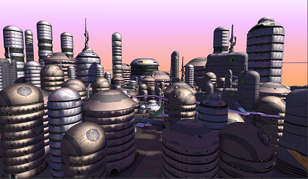

You can render the assembly representations in your scene, including geometry contained by Scene representations and Alembic-based Cache representations. This lets you setup your scene with Cache representations and low-resolution Scene representations for test renders and lighting tests. You can then switch to high-resolution Scene representations for final renders. Scenes containing Assembly representations can be rendered using batch render (Render > Batch Render ) and single frame Render > Render Current Frame commands.
