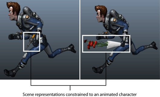

- Constrain assembly reference members to multiple target objects.
- Switch between representations of a constrained assemblyReference node without losing the constraint behavior.

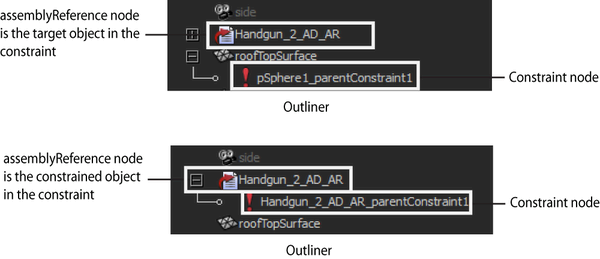

When you constrain an assembly reference member, the constraint node appears in the Outliner under the constrained assembly reference members. As with constraints between typical Maya objects, the constraint node is a child of the constrained object. However, in the case of assembly references, the constraint node is not a member of the assembly reference.
