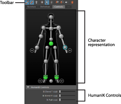

Controls tab
To open the Controls tab
  • Open HumanIK (Skeleton > HumanIK) and select the Controls tab at the top.
The Controls tab contains the following main areas:
The following table provides a brief overview of tasks using the Controls tab.
