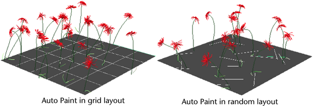

You can quickly fill a surface with strokes without painting them individually or copying and pasting them. There are two ways you can do this:
  • Automatically paint multiple strokes on a surface in a grid layout.
  • Automatically paint multiple strokes on a surface in a random layout.
