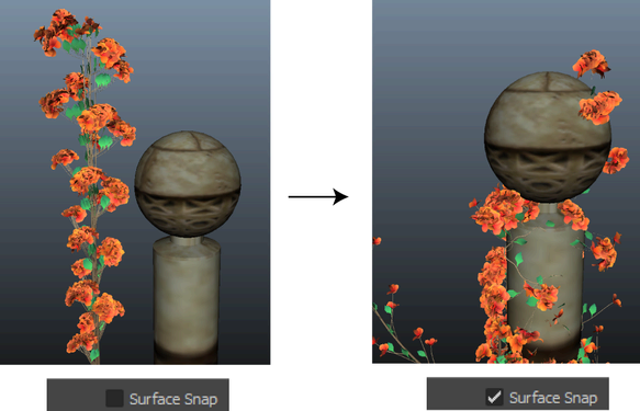

Surface Snap.
The start position of each tube now snaps to the closest points on the surface of the collision geometry.

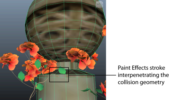

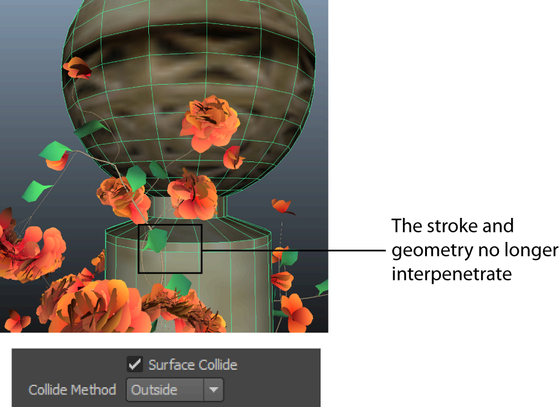

- If some strokes interpenetrate the geometry, and you want to prevent this, turn on
Surface Collide.
- Set Collide Method to specify whether the stroke should collide with the Outside, Inside, or Both Sides of the object surface.

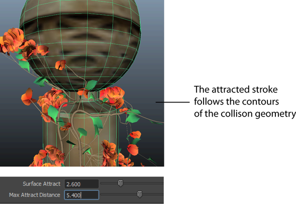

- Increase Surface Attract to apply a force that pulls tube end points back toward the geometry surface.
- Set
Max Attract Distance to specify the area affected by the attractive force.
