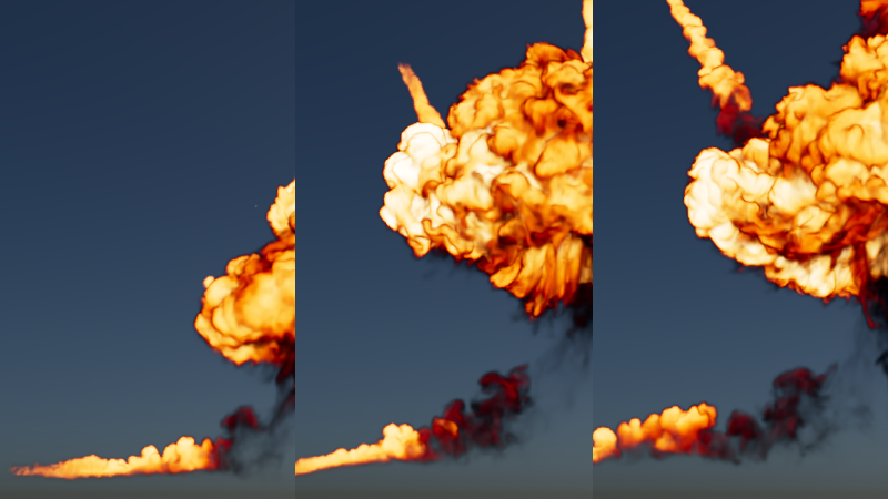

  • The Flow Wedging plug-in allows you to submit a simulation with variations of a parameter ("wedges") to the cloud, freeing up your computer's resources to work on other things while you wait for the results. When they are ready, you can easily load generated caches to compare.
