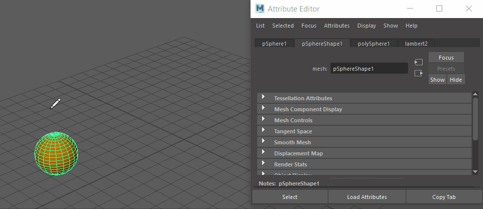

  1. Create a sphere. (Create > Polygon Primitives > Sphere)

  5. In the Custom Sweep Profile dialog, set Type to Poly Face and select a face on the sphere. That face sweeps along the curve.
